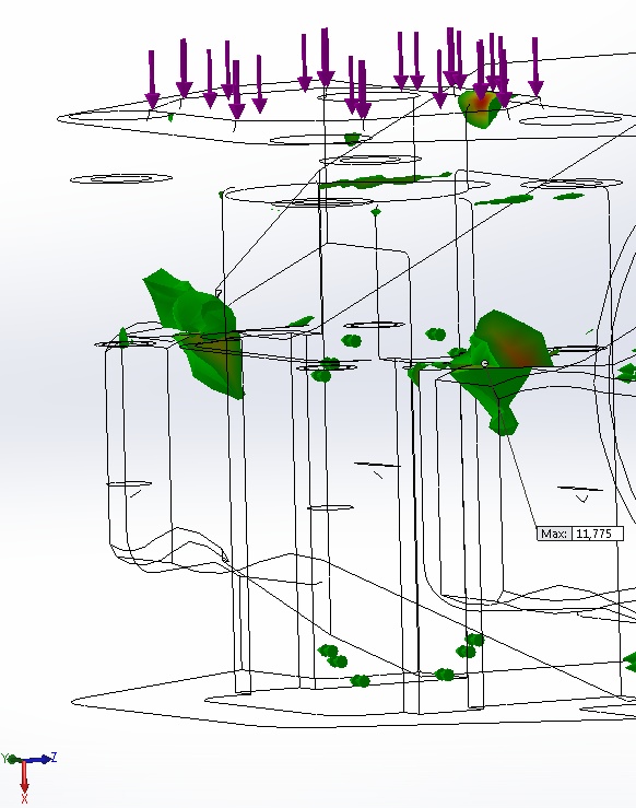

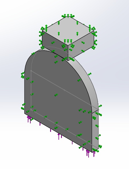

I've got a bearing contact surface with 10mm wide cylinder of 13mm radius against a flat surface.  (Assume steel on steel for starters.)  I'm getting no where near what the theoretical Hertzian stresses should be in a real model I'm working on.  When I run a simplified model and get the mesh down to the order of 1 mm then the stresses are about what they should be (~112ksi)  (Yes, I know I'm mixing units but that's not the problem.)
When I run the same on a full model I get totally unrealistic numbers on the order of 10-50 ksi depending on the mesh size. When I use local volumes at 1 mm mesh size I end up with about 25ksi.  Still totally unrealistic.  Linear Static gives bigger numbers than the non-linear static.

The attached ISO-clip is of an assembly with over 500 lbf going through each side just like the example model.  The shear stresses plots all show way less than 10ksi, no where near the failure limit.

The model I attached in the original post is the same case.  Cylindrical contact on a planar surface, both steel - A2 & 4140 - and the simple model seems to converge but when I run the big model, even though it solves successfully, I get irrational values.  The resultants match the input forces so I know it isn't anything to do with that.

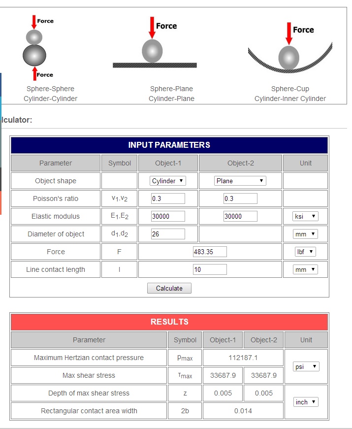

  1. You ran a very simple model of hertz contact and got ~112 ksi from your FE model, which matched well with your calculator.
  2. You then ran your full model and got between 10-50 ksi, with 25 ksi at 1 mm local element size.
  3. Your calculator for the full model gives ~34 ksi as the peak shear stress.

OK, here's a simplified model as promised.  The resultant forces add up (625# up at the pin w/ 500# down on the block & 125# down on the end) but the bearing stress of 38ksi does not make any sense whatsoever.
Have fun and hopefully this group can help me "solve" this problem.

No, the Hertzian stress should be on the order of 110-150 ksi according to bearing contact theory.  The shear stresses were on the order of 50% of the von Mises stress (mostly as expected but accordingly low).

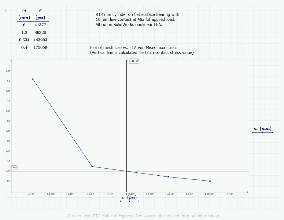

% convergence defines how much the results from a previous mesh differ from the results for the current mesh. There are several different sources of error in a finite element model, one of which is called, "discretization error." Discretization error is the error associated with taking a continuous domain (ie your real world system) and breaking it up (discretizing) into a finite set "simple" shapes (your elements). In general, the more element you have in a model (ie the finer your discretization) the more accurate your results (the limit as the number of elements n approaches infinity is a continuous system).
As such, you'll typically see an asymptotical plot of a result (stress, displacement, strain, etc) as your progressively refine your mesh:
Part of the process of determining the validity of the results for a FEA study is ensuring that they have converged, meaning that you want to make sure your mesh is such that your results have "leveled off." Did you do anything like this?

For some reason I can't seem to get the picture you inserted to load.  However, I understand your meaning.  If you look at the plot I posted in the original question I attached a curve which shows just what you are stating - however - this was with the very simple model (pic also attached) with similar contact geometry.
The model attached in a latter post is much closer to the actual assembly I am analyzing.  I ran it with the localized mesh size that was promising in the converged simple model (1 mm) and it came no where near the theory number.  I'm currently running the real assembly with a local mesh of 0.1 mm (0.25 mm didn't come close) in linear static.  It'll run over night, I hope - 5.5 M DoF - and it's been going for 2 hours now.

I'd like to think you are right except for the fact that with the simplified model I used 1.0 mm mesh to converge and at a smaller mesh size (shown on the plot) it over-predicts accepted theory - which in and of itself isn't necessarily a bad thing.
However, last night I ran the 'real-life' part with a localized mesh on the two surfaces in question and only got 50% of what I should be seeing (75ksi vs. 150ksi).  That monster has 5.5M DoF and ran for some time.  I'll try a 0.05 localized mesh and let it run over the holiday weekend.  One caveat: this only sucessfully ran in linear-static when, by rights, this is considered a non-linear FEA problem and I can't get that to behave.
