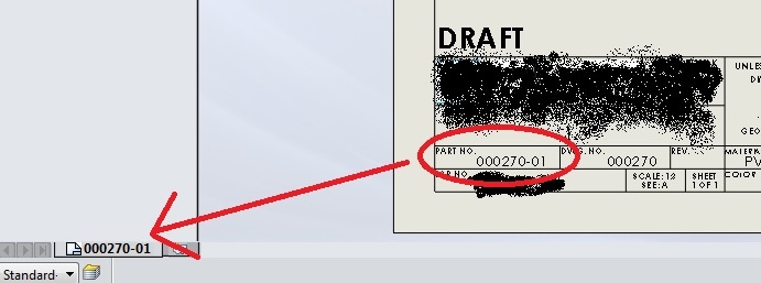

Currently our system admin has set up a fantastic template that automatically fills in our title block based on custom parameters in the model file. I'm wondering if it's possible to get the drawing sheet tab to be automatically renamed based on one of these parameters. For example, see attached image.
I've renamed the tab to match the part number listed in the title block. I am going to be adding additional sheets, and I'd like each one to have the sheet tab match the part number shown on the drawing (these are family parts, so all parts are shown in a single drawing, but on different sheets).
Is there any way to do this?
