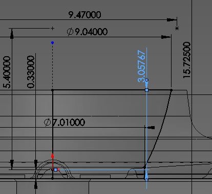

This is what it should be. Part number 1:

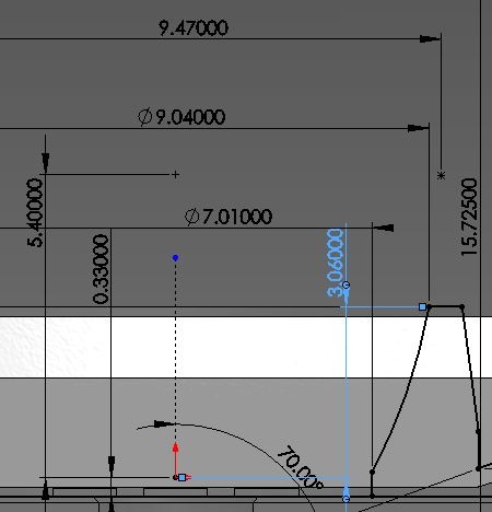

This is the mating part and the dim that is creating the issue. Part 2:

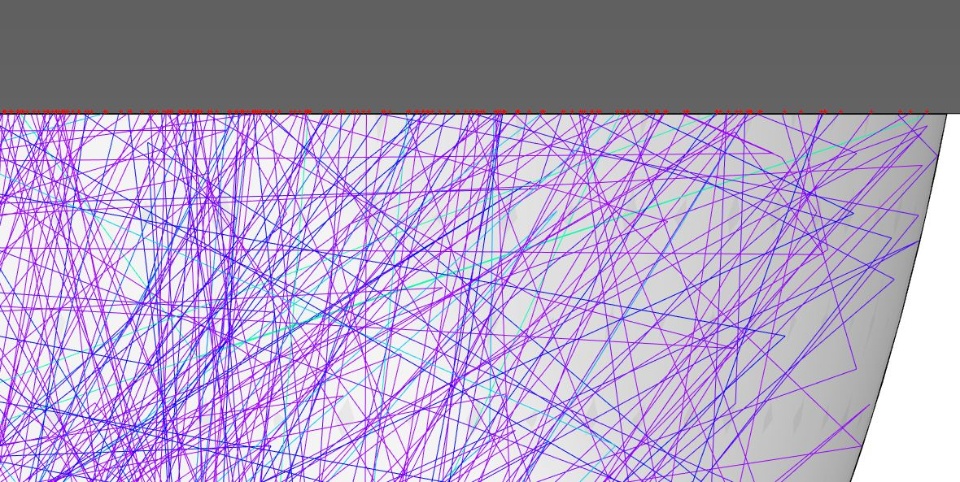

Here's the issue it creates. The ray trace software expects the surfaces to be defined as far as the internal and external materials. It expects to "see" two mating surfaces in this case but does not and so show error points as an "x".
