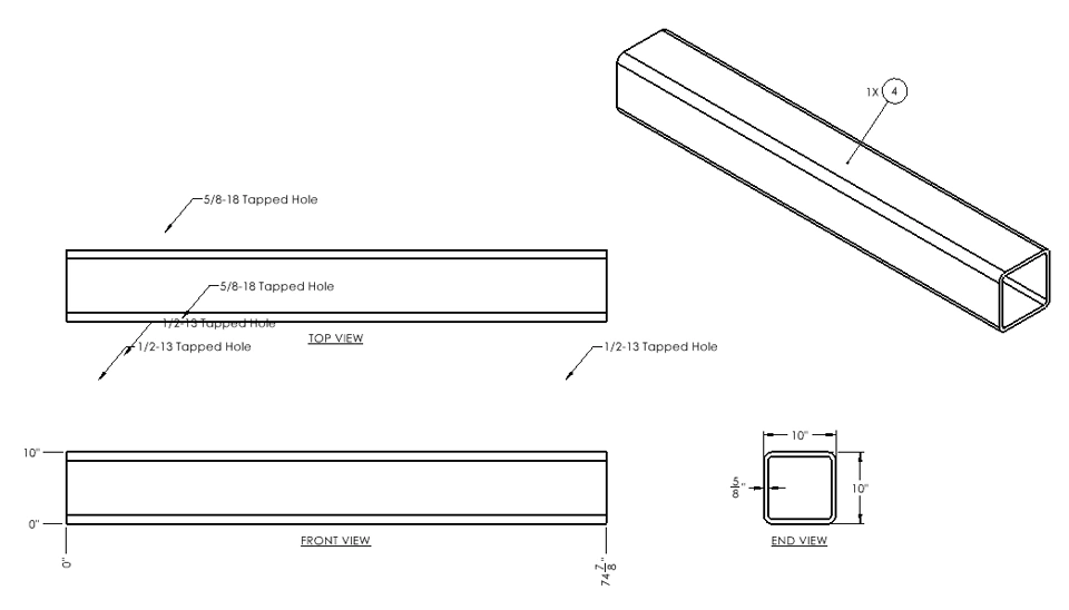

I'm having annotation issues on drawings for multibody parts that are derived from a "Driver Model". I don't have access to the driver model, and I feel like that is where the issue stems from. I'm just hoping someone can either confirm that or tell me what I'm doing wrong.
Every time I save the drawings at the end of the day and then open them sometime later these annotations (and phantom threaded holes) reappear. Here is a screenshot...
