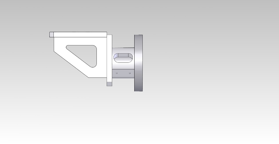

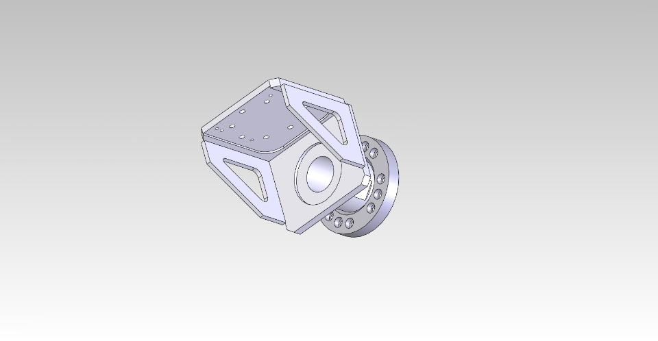

This is the bracket on which i am running a linear static study:
(Isometric View)
Front View

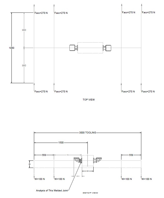

Given below is the schematic of assembly where this bracket is used:
Basically this bracket holds a part through 4 vacumm cups ( on one side) , the total mass of the part is 80 Kg and accelration forces are 270N acting horizontal through each of these 8 vacumm cups. ( I assumed that total mass is equally supported by all 8 cups hence 80/8=10Kg (100N) force acting through each cup)
I basically want to find out if the stress due to these forces are not causing the bracket weld to fail. ( Cause some of these brackets failed at our customer site)
