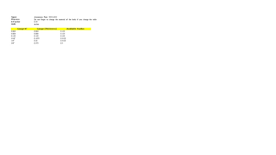

Looking for a generalized gauge and sheet metal bend table for Aluminum. We are not a fab shop, but I make all my own sheet metal parts and send out the drawings for Fabrication.
Searched google for information, and though I can find the gauges I have not been lucky enough to find the bend radius and the k-factors. Does anyone have anything they could share?
