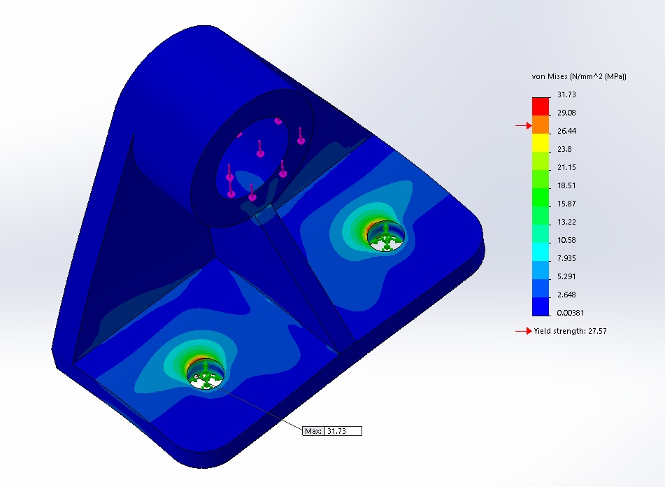

I have a Bracket to analysis.
Force applied as below on bottom half surface of the hole and fixed at two holes as shown.

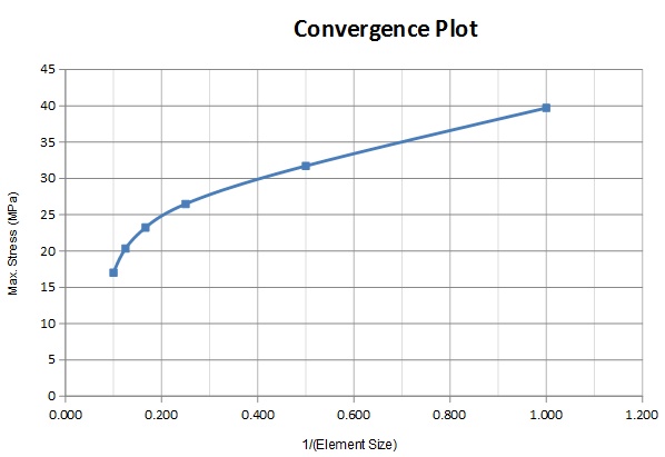

my problem is when do the convergence analysis (convergence plot) for this model, it isn't converging.
Also maximum stress at the fixed hole edges greater than the material yield stress.
do I have to consider this results ok or what are the other methods to do the analysis.
if this is ok, how I justify this analysis and results.
