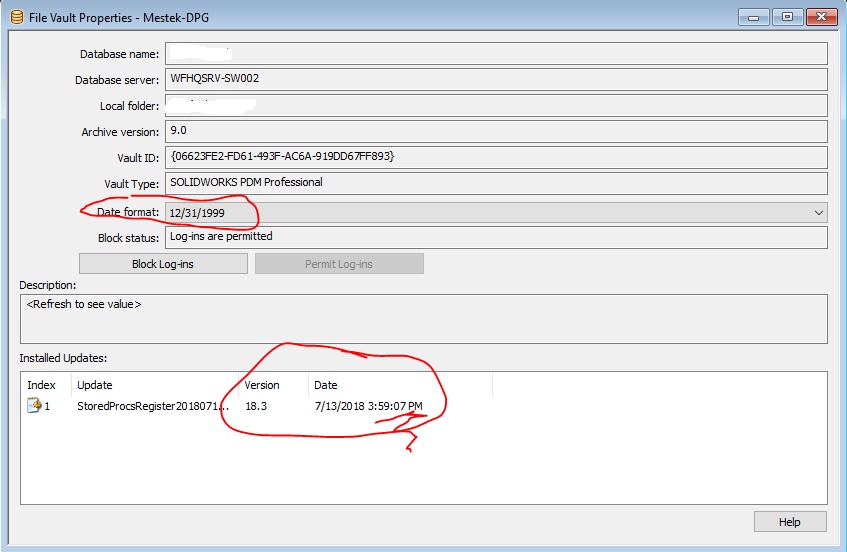

After upgrading to 2018-SP4 now vault date format setting is ignored and the default shows date and time.
Has anyone upgraded their PDM Pro to 2018-SP4 and are now having trouble with the Date format setting? All documents now that were previously written to with the correct date format, MM/DD/YYYY, as per my vault settings are now getting date plus time entered into the date field. No matter what I try it persists to write in the same format. All my documents have the correct "short date" setting. Nothing has changed with the file cards, folder cards or templates. My Windows settings for "Short Date" are correct.
