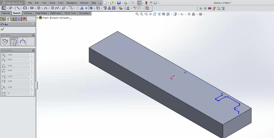

'create extrude cut profile
swModel.Extension.SelectByID2 "TOP PLANE", "PLANE", 0, 0, 0, False, 0, Nothing, 0
swSketchMgr.InsertSketch True
swSketchMgr.CreateLine 0.2525, 0.014, 0, 0.2475, 0.019, 0
swSketchMgr.CreateLine 0.2475, 0.019, 0, 0.2325, 0.019, 0
swSketchMgr.CreateTangentArc 0.2325, 0.019, 0, 0.227, 0.0245, 0, 1
swSketchMgr.CreateLine 0.227, 0.0245, 0, 0.227, 0.0425, 0
swSketchMgr.CreateLine 0.227, 0.0425, 0, 0.222, 0.0475, 0
swSketchMgr.CreateLine 0.222, 0.0475, 0, 0.176, 0.0475, 0
swSketchMgr.CreateLine 0.176, 0.0475, 0, 0.171, 0.0425, 0
swSketchMgr.CreateLine 0.171, 0.0425, 0, 0.171, 0.018, 0
swSketchMgr.CreateTangentArc 0.171, 0.018, 0, 0.169, 0.016, 0, 2
swSketchMgr.CreateLine 0.169, 0.016, 0, 0.161, 0.016, 0
swSketchMgr.CreateTangentArc 0.161, 0.016, 0, 0.159, 0.018, 0, 1
swSketchMgr.CreateLine 0.159, 0.018, 0, 0.159, 0.0425, 0
swSketchMgr.CreateLine 0.159, 0.0425, 0, 0.154, 0.0475, 0
swSketchMgr.CreateLine 0.154, 0.0475, 0, 0.011, 0.0475, 0
