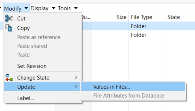

For Ex : 01. Part A --> get latest version .
             02. Go back to the folder and update 'values in files' from folder level for checked out 'Part A'.

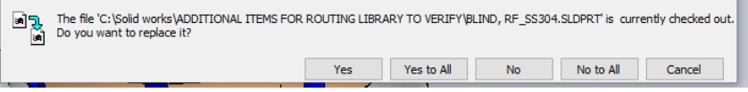

03. If i check the 'Part A' version inside teh folder, again it asks for get  latest version
04. If I click on get latest version.
Also i tried check out both part/assy & drawing file, open in solidworks application. If I just save the drawing file and check the data card, above step 03 & 04 arises.
