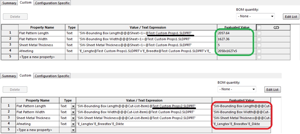

Adding Custom properties from cut-list properties not always correct
In a macro I am trying to add custom properties (and equations) for an active part.
Adding these properties works but the evaluated values are not always what I expect them to be.
When the procedure 'Show_All_FolderProps' is run then the immediate window is filled with the folder props and cut-list properties.
When I then enter the 'formulas' from the cut-list properties for 'Test Custom Props1.SLDPRT' in the custom properties window this is OK.
When I do the same for 'Test Custom Props2.SLDPRT' this is not OK.
Does anybody have an idea why the formulas in 'Test Custom Props1.SLDPRT' are giving an expected evaluated value and in 'Test Custom Props1.SLDPRT'  this is not the case?
