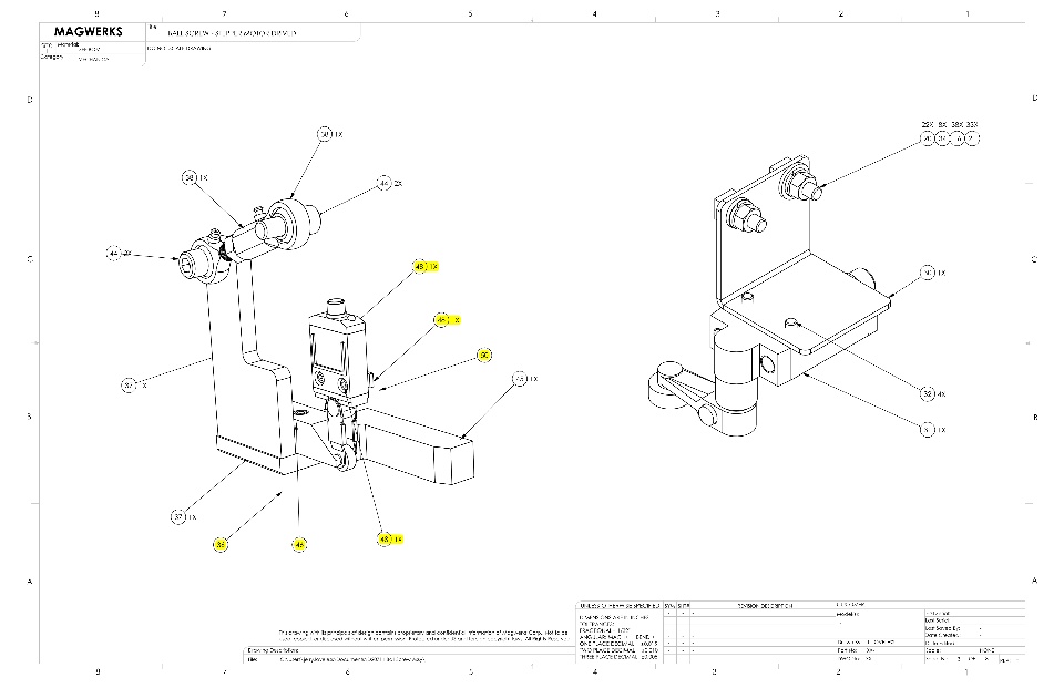

Hello everyone, Subject: Adding Balloons to an Isometric View not attaching to individual details.

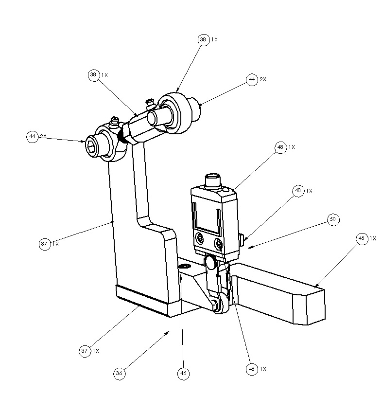

I use in my Drawing Sheets Isometric views of Sub-Assy's for the guys on the shop floor to aid in assembly. The problem I have is that when I show an Isometric view in the Drawing, start ballooning, weather I use Auto-Ballooning or not the arrows point to empty space and actually are the correct Detail/Item number match in BOM. This is not an Exploded View either it's part of a Display state I set-up. Note at Limit Switch I have place Balloons on three different items and it shows as #48 for all. I added the Auto-balloon to show where SolidWorks thinks my parts are at (50 in space should be where #48 is)
