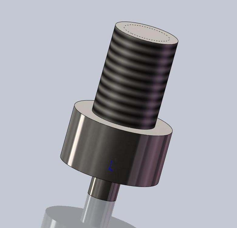

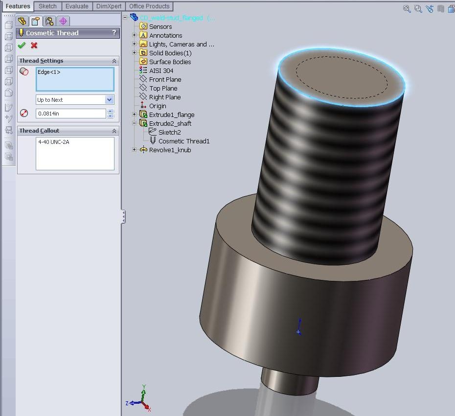

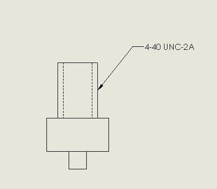

I am modeling a weld stud, and would like to add the external cosmetic thread annotation (note) to a design table (SW2009). This thread callout note seems to only appear in the drawing, and not in the part model file, although the minor diameter is available. I have been able to add the dimensions to the design table without problems.
If necessary, I could make this part without a design table using configurations. However, I would like to have the correct thread callout annotation note (2-56, 4-40, 6-32, 8-32, 10-32, 1/4-20, etc.) for each derived configuration. Can this be done using design tables, or some other means?
