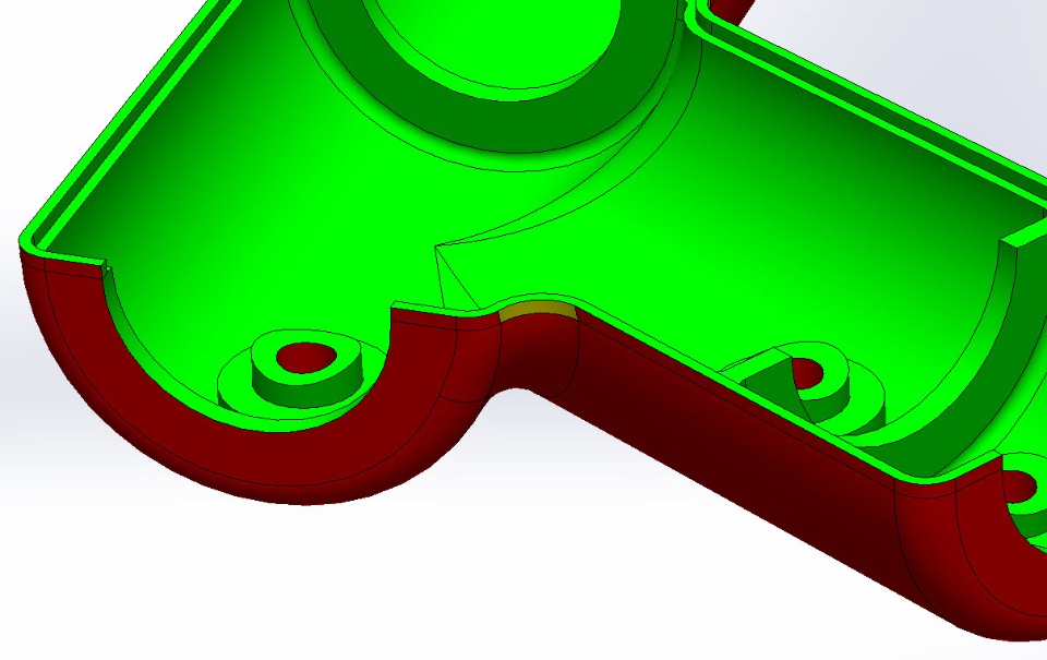

Hi All,

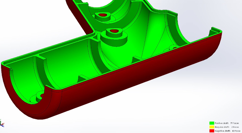

Have been battling this problem for the last few hours without any success. I'm trying to finalize the addition of several drafts to this injection molded component. For some reason it wants to reject every attempt at drafting any chain of faces that contain an internal radius feature. The Lip/Groove feature was added towards the end of the modelling process and prompted the need t create additional draft features on the "male" side. It's this same lip feature that's resisting all attempts to be fully drafted. As shown in the second image, the chain of faces that don't contain an internal radius drafted fine. Any ideas out there ??? (SW2014 SP3 file attached)
