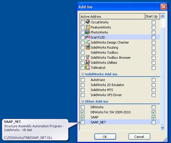

swAddin listed in registry and Tools->Add-Ins see attached JPG "swAddin_Listed.JPG"

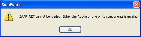

DLL not Loading in SolidWorks and gives the following error in 32bit environment and No response in 64bit environment.
"SAAP_NET" cannot be loaded. Either the Add-in or one of its components is missing - "swAddin_Error.JPG"

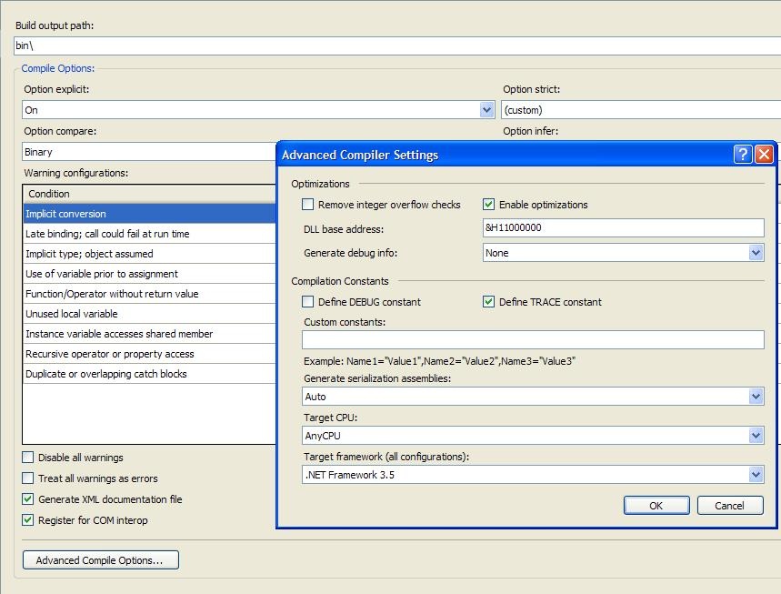

Find the DLL's compile settings in "SAAP_Compile.JPG"

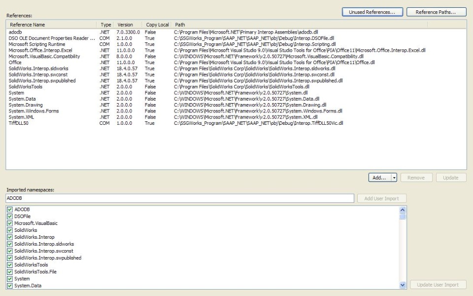

and AddIn References in "SAAP_Ref.JPG"
Also I checked "Make assembly COM-Visible" and Using "Strong Name Key file"
