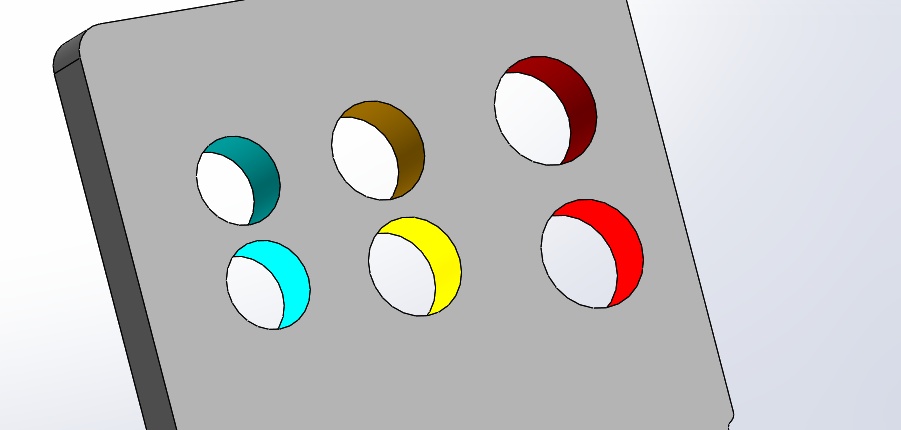

I am experiencing an issue where face colors applied trough a company custom add-in do not display as intended.
This was first encountered in an add-in that took assembly-wise screenshots with a subassembly colored for reference; it did not cause problems there, as the exact color was not relevant.
However; it has now also surfaced in our holes, here it is relevant, as we use these colors to quickly identify mismatches on the 3D-check.
the attached image displays the effect: the top row is the color as is desired, the bottom row contains the exact same hole as it is added.
This is especially a problem with the middle set (the yellow/brown one), as the yellow color is also used for a similar hole, slightly smaller.

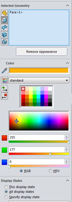

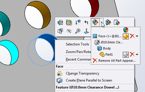

When i right-click the face, it shows the correct color; and it is indeed this color that is entered into solidworks by the API (i checked; the correct RGB is passed)
If i open the appearance editor in this way; the correct color is shown and previewed, but if i cancel out of the menu, the 'wrong' one is reapplied.
