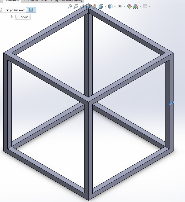

Im trying add force normal to face. I divide face, and select part which I want add force.
This is my construction. On right you can see divide part of face, which is selected, but force didnt add.

I have error from swsForceError_e: swsForceErrorApplyNormalForceToFacesAndShellEdges <> You can only apply normal force to faces and shell edges.
Probably I give wrong argument of function addForce3(..), but I dont know what is wrong.
