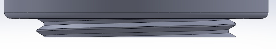

I am trying to add a thread profile for a 1-1/4"-24 UNS thread in Solidworks 2016 toolbox and am unable to do so.  I have created the profile as such:
Series:  UNS
Thread Dia: 1.25
Advance: .04167
Thread Minor Dia.: 1.2415
Thread Minor Dia Inside: 1.2487
Tap Drill: 1.1991
Thread Description: 1-1/4-24 UNS
Threads Per Unit: 24
Full Size: 1-1/4-24
I want to be able to use the THREAD feature and have Solidworks actually cut this thread profile.  The attached example exists in Solidworks and is a 1-1/4-12 thread.  I am looking to generate a 24-pitch thread profile.
