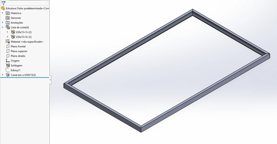

The file is a structural component.
I created a frame and used the 30x15 "U" Profile.
This frame has dimensions of 1000mm x 600mm.

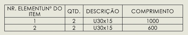

When generating the cut list in the drawing environment, the table is displayed as below:

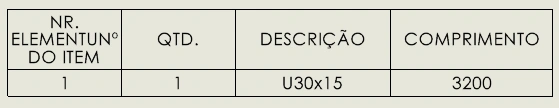

It is possible to create a configuration for the sum of all components to be added in a single line:
The reason for this is that the user wants to generate a table and send it to the commercial department to purchase the profile.
This way they would not need to add the lines and would already have the total length of the profile in a single line.
Is this possible?
