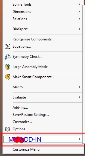

I've no idea if this is a SW bug or not but everything in my code is correct in reference to the location of my add-in menu. When I first start SW, (no open docs) the menu shows up in the correct location, it's the first item in the tools pull-down after the SW menu items. Something happens when I open a document that sends my add-in menu all the way to the bottom of the list. Has anyone seen this type of behavior? Is there a way to modify this via the registry?
