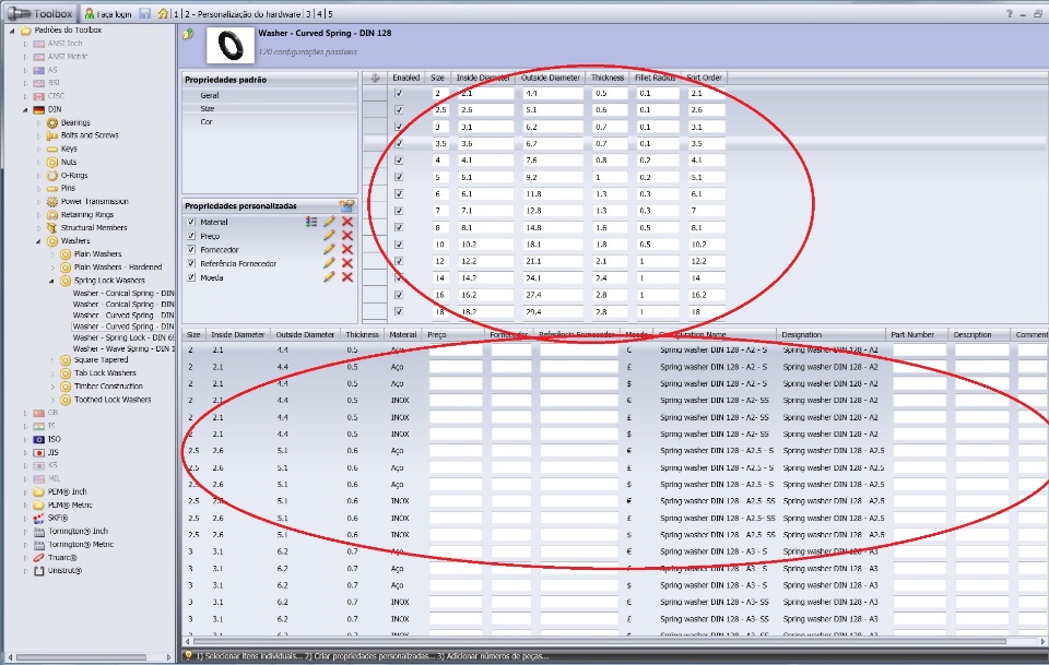

I lost a day trying to add an washer to the toolbox, and it wasn't possible.
It's DIN 127 B.
This washer doesn't have fillet's and have a gap, so because of that I couldn't use anyone of the ones already available in the toolbox.
I could create in an design table the configurations I want.
But when I add the part to the toolbox I can see the configurations.
I would like to have the same options as I show in the attached image.
Is it possible to do?
