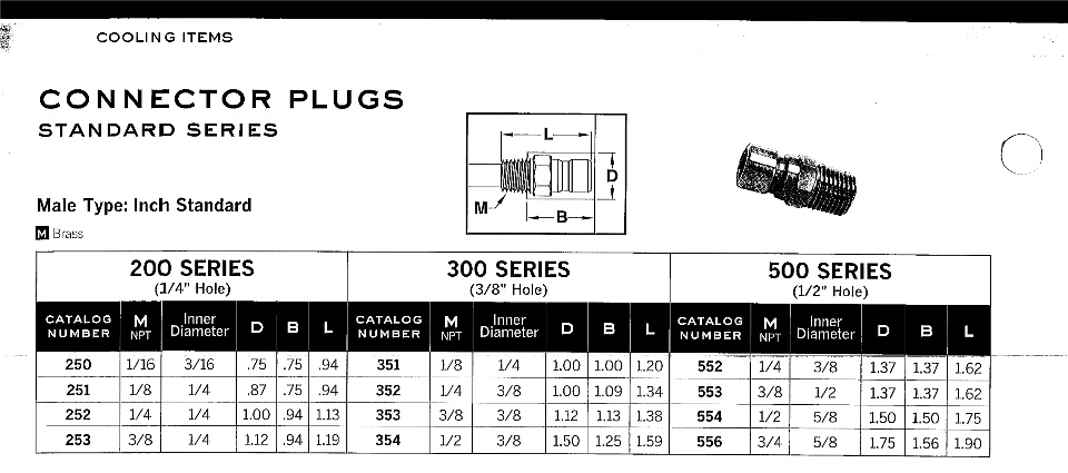

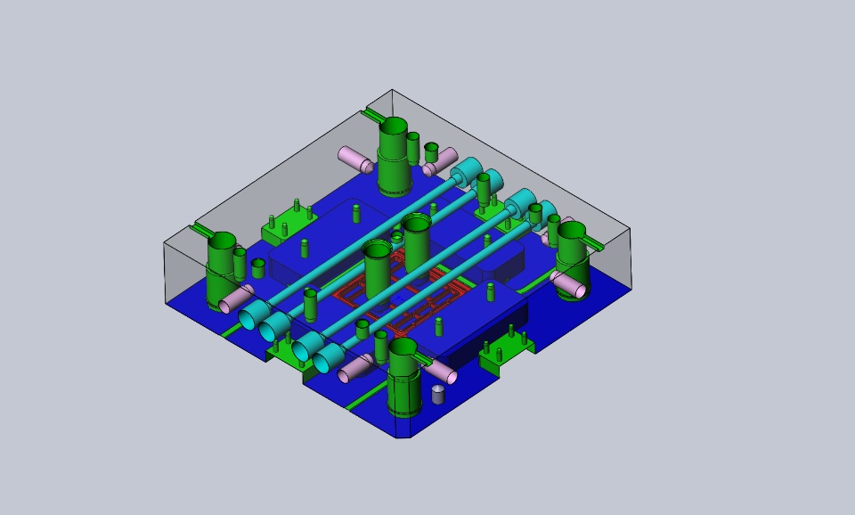

I'm a mold designer, so every job I do has plates with waterlines (tapered pipe tap holes).  The vast majority of our customers want the waterlines to have c-bores so that the fittings sit just below flush (protects the fittings).  Here is a picture of a mold cavity plate with c-bored waterlines (waterlines are cyan):
I personally would so love it if SW would make the c-bore an option in hole wizard, thus adding the c-bore info to the hole call-out in the drawing.
