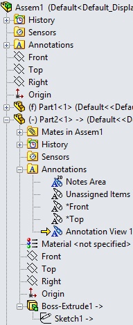

HI all,
Attached image show what i want to have which is the activation of a specific annotation view in a component in an open assembly.I have tried different methodes but still unable to reach my goal perfectly .
In fact i was able to activate the view and show it.But my problem is that I had to activate the component to activate its annotation view .
So i must call ActivateDoc3 which open the part document in new window and i do not want that, i want to activate annotation in component with api as if i was using user interface.
Thanks
