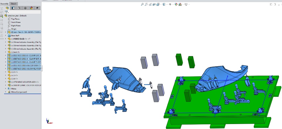

Hello, all;
I'm trying to write a macro that activates an Advances Selection query I have that hides some components prior to saving off STEP files. I'm having trouble as the documentation mentions a .sqy file, but I'm getting a XML file when exporting my set up advanced selection?
I've tried recording the macro steps of turning this advanced select on and I just get a blank macro file.
Any assistance would be greatly appreciated!
This is what the advanced selection does when activated. I then want to hide the selected components and save off the step... which should be easy enough.
