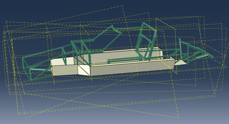

I'm modelling a space frame chassis, inbetween some of the beam sections I want to apply surface shell sections - to create a sort of monoque but with the beams present.

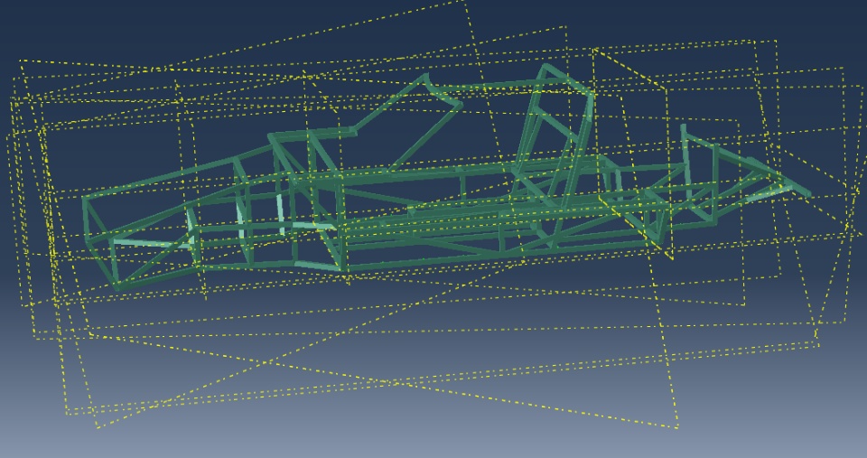

Now I've done this but the beams seem to disappear when I apply the shell sections, almost as if they're replacing them. When I suppress the shell sections the beam sections reappear.
Is this just a case of rendering or are the beam elements actually gone? I spoke to someone who said you cannot have two different types of elements going through the same node - is this true?

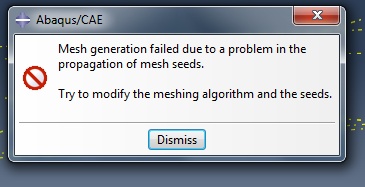

I've tried meshing the whole thing and getting the error below
I've attached images for better understanding
