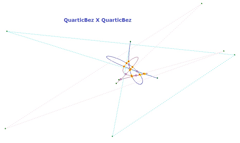

Last year I had presented my solution to find all of the intersection points in between two CubicBez plus its self-X at this forum, and now I am going to show you my X points solution for QuarticBez too. Besides that I have also enhanced the precision level of my solutions, all of the deviation can be controlled in the level no higher than 1.0e-9, which means my solutions are ready to be used as a stable tool of application now.
Welcome to challenge the correctness of my data!
| Data | Picture |

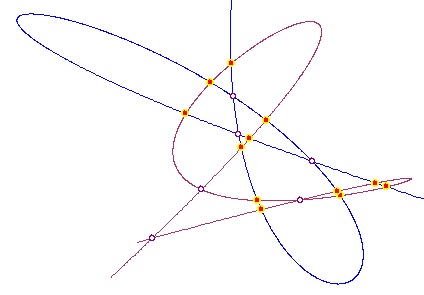

Blue Curve: degree 4, control points, Self Intersection point at: Red Curve: degree 4, control points, Self Intersection point at: The Intersection point(s) of these two curves:
| Data | Picture |

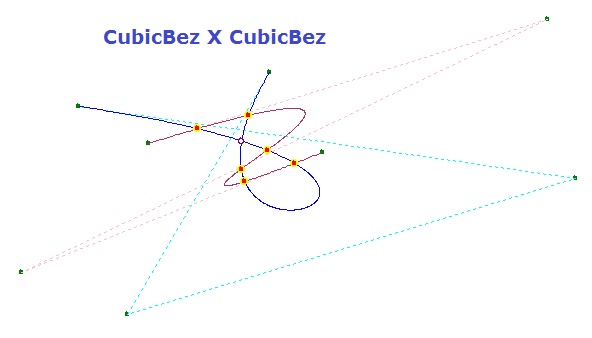

Blue Curve: degree 3, control points, Self Intersection point at: Red Curve: degree 3, control points, The Intersection point(s) of these two curves:
In the above two examples, I have presented the data of intersection points between two curves, self-intersections within each single curve, the coordinates of those X points and their responsive t values and each of their control-points for your reference. Welcome for anyone to challenge the correctness and precision of these data!
