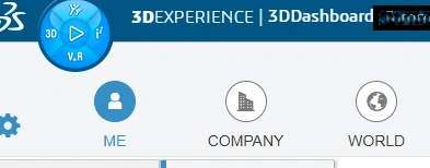

  13. What is this Me/Company/World nonsense?  I've never needed to use the Company/World tabs.

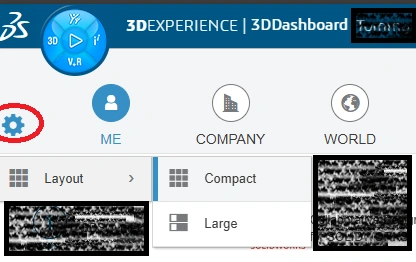

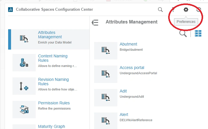

  16. Related note: Options buttons that don't give you the options you expect.  Think this prominent Gear icon will give you platform options?  Think again!  It just changes the veiw of your many icons so you can choose how overwhelming they are.
    Think this Preferences option from the home screen drop-down will do more?  Nope!
    It gives you the name of the platform you're on, with a text field that you can't edit but you can Save, apparently.
  17. The number of actual options is ridiculous and impossible to filter through, if you can find them.  See how small that scroll bar on the right is for just one of the sections on the left?  Oh, most of those options don't actually apply to you given your roles. Just FYI.

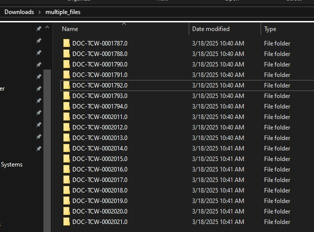

  22. I can use Bookmark Editor to download files, but if I download them more than 1 at a time, they come in subfolders marked with... their file name.  Which is not their title - it's a platform-assigned ID which you can't change.  Good luck figuring out which file is in which folder!  Here I downloaded some of our Solidworks macros. I think.  There is 1 macro file per folder, naturally.

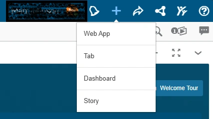

  34. Now we get to adding content to the platform.  Oh, it's done with this big + sign in the upper right corner correct?  Wrong.

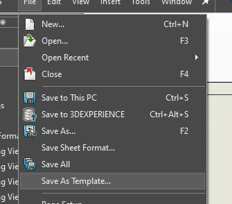

  37. Drawing templates (.drwdot) still need to be saved from Solidworks via this new command:
    But if you save the drawing template the old way with a Save As, then the template will be in Draft state and no one else will see or use the new template you just made...
