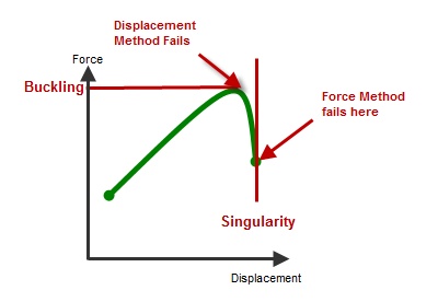

The Displacement Control Method is based on knowing the Force-Displacement curve (represented by the displacement versus time curve) for a certain degree of freedom. The specified displacement is incremented and a loading parameter is evaluated for each step. The solution singularity faced by the Force Control Method is resolved by knowing the prescribed displacement of the controlling DOF, enabling the solver to evaluate equilibrium and calculate the response for the whole model. However, the method fails due to singularity when the slope of the Force-Displacement curve becomes vertical (infinite) as shown below:

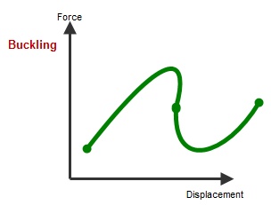

The Arc Length Control Method seeks equilibrium by sensing the slope of the Force-equilibrium without prescribing displacement or force at a solution step. It is the most powerful but it is slower than the two other methods. The method can be used to study post-buckling and snap back buckling as shown by the Force-Displacement method shown below:

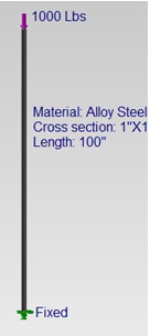

Consider a column made of Alloy Steel with dimensions 1”X1”X100”. The column is fixed at one side and a compressive force of 1000 Lbs is applied to the other end as shown.

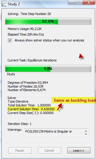

A buckling study calculates the buckling load factor to be: 0.62655 or a buckling load of 0.62655x1000=626.55 Lbs (closely agreeing with the theoretical Euler solution).
A Nonlinear study with same loads and fixtures and default settings (force control and default linear time curve) stops at the same buckling load:

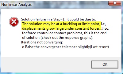

Giving the message:
