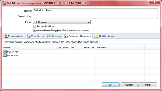

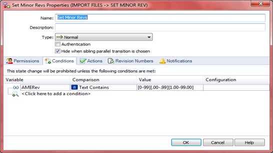

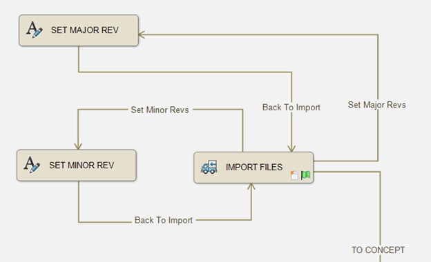

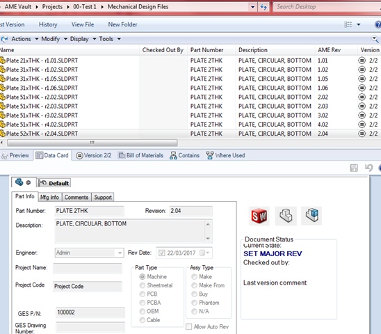

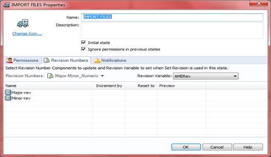

I'm new here. Currently my company is implemented PDM Pro 2016 version and I have tried to use the Set Revision Command to import existing revisions for the Major and Minor revisions, such as, 1.02, 1.03, 2.02, 3.04, etc. The Major component revision created with number 0-99 and the Minor component revision created with number 00-99. The Revision Number created by using Major (dot) Minor or Major.Minor. Currently, the Set Revision Command is working for revisions 1.02 and 1.03 and the State revision tab has a minor revision component increment by 1 and the major revision component is blank. I have tried to set the major revision component to increment by 1 to see if it works out using the Set Revision Command for those existing revisions 2.02 and 3.03, but there was a warning message "A card variable value does not match with any of the revisions present in the list". I have a transition condition with revision variable --> Text contains --> [0-99][.00-.99][1.00-99.00]
Does anyone knows how to resolve this problem that I ran into, please help.
