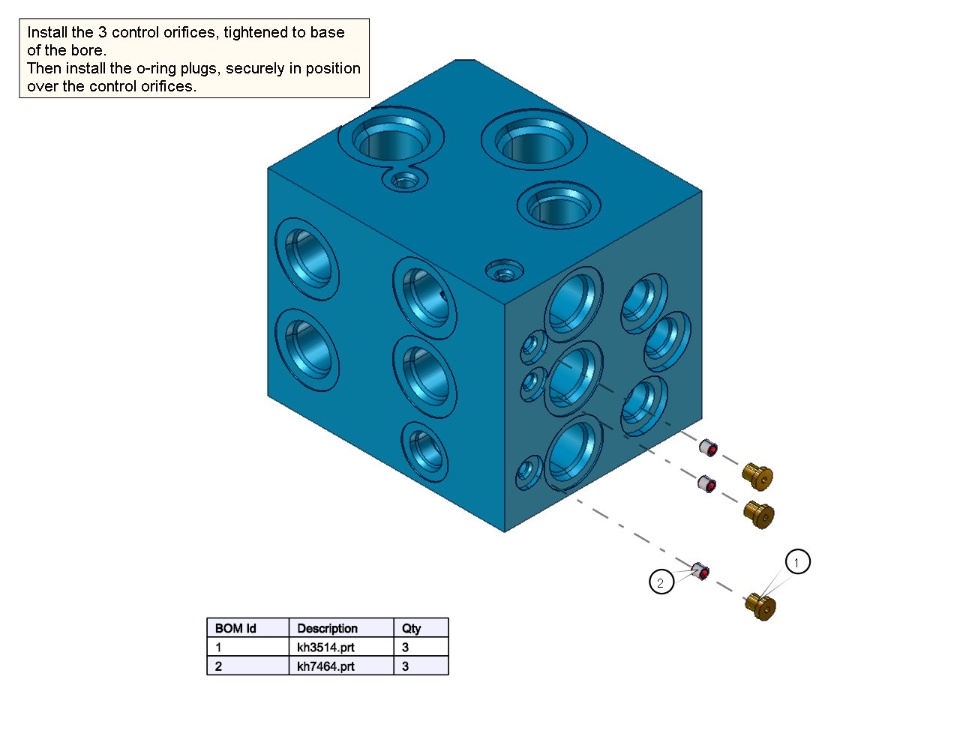

I'm having a problem creating a BOM with a description field for the items in the viewport. (Note: when I use a Solidworks model I have no problem). When I import a model from Pro E Wildfire 5.0 to 3DVIA Composer and try to create a BOM the selected item part numbers show up in the BOM description field (see attached image). I need a part number column and a description column. The BOM id and Qty are fine. Also the engineering department assures me they are putting the descriptions and part numbers in the correct areas. Any help would be greatly appreciated.
