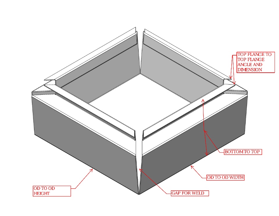

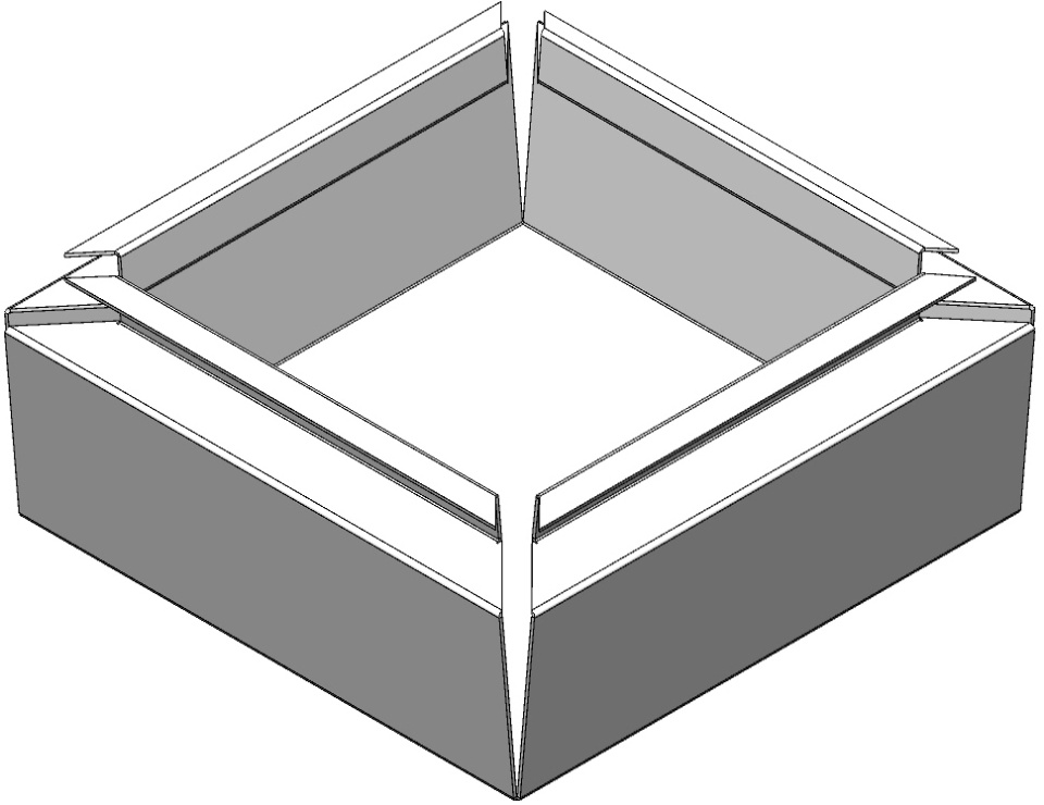

Here is a single piece box, with angles exaggerated.
I need a tolerance stack that shows the interaction of the four stack tolerances one for each side.
Then I have to look at how that affects the top flange.
Here is a side view of the box, we need to keep the gap from side to side where the flanges meet to a set tolerance.
We also have to keep the OD width & OD height to a set tolerance.
Most important we have to keep the top flange parallel and within a flatness tolerance.
