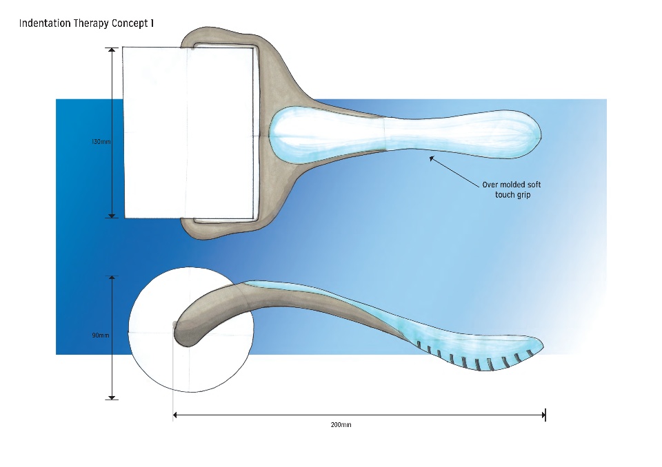

I am having trouble modelling a handle with a organic profile.
The current method I was using was to use a combination of 3D sketches as profiles lines to loft circle shapes together, to model the top of the handle. However this method doesn’t seem to be working for me and can’t see how the end result would be symmetrical.
I was wondering whether anyone could point me in the right direction in how to achieve this goal, or suggest a better method to use.
I have attached the solid works files. The circles on the two created planes are wider then the original sketch, as I needed the gap between the two to be 134mm.
