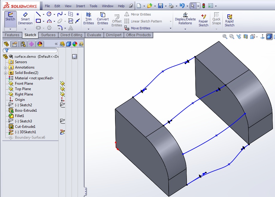

Constructing section curves for a surface using multiple points and splines in a 3d sketch as image
I can set end conditions on the splines which are connected to the edges and control the bulge with the sketched point.
If I try and set tangent end conditions for the curve adjacent to the surface rather than edge then the point repositioned by the system - without end conditions the point can be any where in 3D, set end conditions and it moves th point.
Any ideas?
can't set end conditions on a 'curve thru' ref points'?
Am i going to have to build a plane and a 2D curve?
