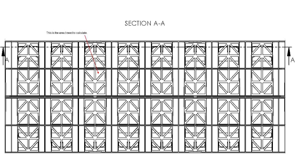

Any advice would be greatly received.REPLY 1(I dont seem to be able to press the reply button on the message so I have had to edit the mesasge) - Hi Chris, thanks for the reply, I have hopefully attached a image of the simplest side of the model I am looking to find the open area of. This is probably the easiest one to do but I cant upload the other sides due to confidentiality. I have identified one of the areas on the image so you can see that it is the open area of the structure I am looking for a quick way of calculating.

Message was edited by: Stuart Ramella                                REPLY2: Thank you for your advice Chris, I was looking for something a little bit simpler then the convert entity sketch way you describe. When I tried this the selection process was dificult to carry out because there are so many lines (there is a small draftdown each cut out and a radius in each corner), I couldnt find a select chane, Once i select a line by mistake useing ctrl I couldnt unselect and when i convert, it overlays the line in black so i cant see it against the drawing view (I should add that I am new to SW). In Solid Edge you can just click on the area and it will highlight the internal voide hence I was looking for similer simplicity.    Reply 3: Thanks for the advice Jerry, I will give it a go.
