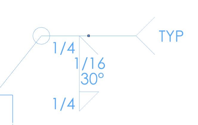

First off I am running 2014 Sp2. I think the enhancements to the weld symbol dialogue are good but I have noticed something and I wasn't sure if it is just us.
When we use the 2nd fillet the text for the root opening and groove angle now go between the 2 symbols which I think is where they should be. The problem is that ours seem to be center justified. If we put a number in with more than 2 charactors (any fraction) the text crosses the line. I can work around this by putting spaces on the front but was wondering if anyone else noticed this? Is there a way to change the text to left justified?
