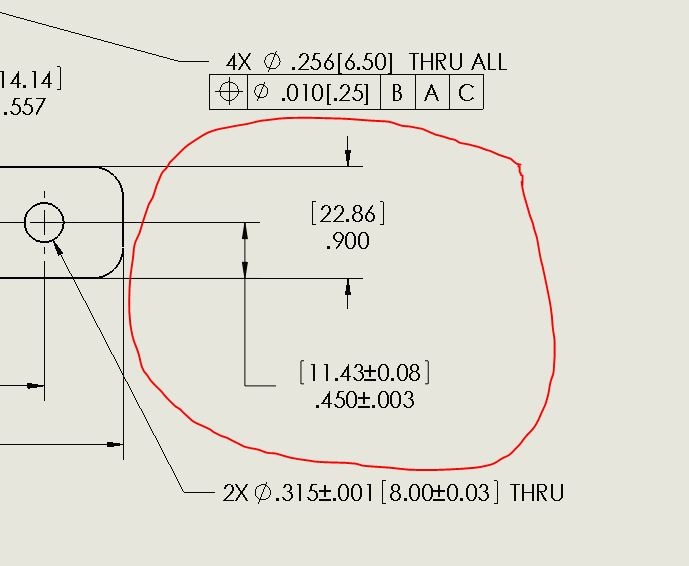

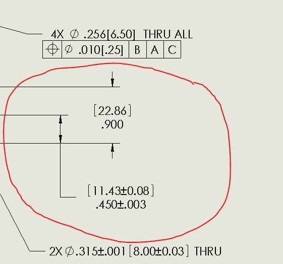

We have just migrated from SW2010 to SW2014SP5 and are experiencing an issue with the display quality in drawings.
With the anti-aliasing setting turned "ON" it is causing the dimensions, notes, etc in the drawings to be blurry / fuzzy looking.
It is a subtle blurry effect mostly seen on overlapping witness lines, leaders, etc. which after time causes some eye strain and fatigue.
With the anti-aliasing setting turned "OFF" it clears the drawings up.  (See the attached images, hopefully the effect shows up.)
The problem with it "OFF" all the time is when you switch back to your models all the model edges are jagged, (which is why you use anti-aliasing to smooth this out.)
In 2010 this setting could remain "ON and would not influence the display quality in drawings. (as I understand is how it should work)
The only way around is to be constantly turning this function "on and off" as you switch back and forth, which is not how it should work.
We are running HP EliteBook 8770w computers with Nvida Quadro K4000M video cards w/ Latest SW approved drivers.  These computers are dock & connected to two monitors w/ primary monitors running 1920 x 1200 resolution.
