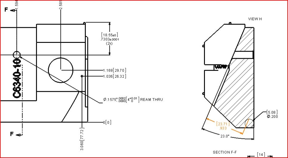

Back in beta there was a discussion with the way the new sectioning works in drawings & having a jogged section view stretch to include the distance that the jog creates.
https://forum.solidworks.com/message/308158#308158
When you create a section view using the "old method" of sketching lines you get an option to create a foreshortened or aligned section view but nothing if you modify a section view to create a jogged section
I see that in SP0 this is still true when modifying a section view by sketching your own section lines. Is this going to be the norm or is there going to be a section view option or system option to not allow the section view to grow when it is created with a jog. I can see those doing molds or dies being very frustrated when their plates are done incorrect because of this.
