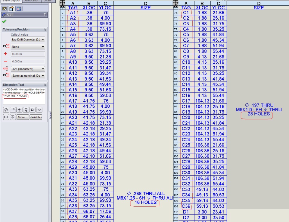

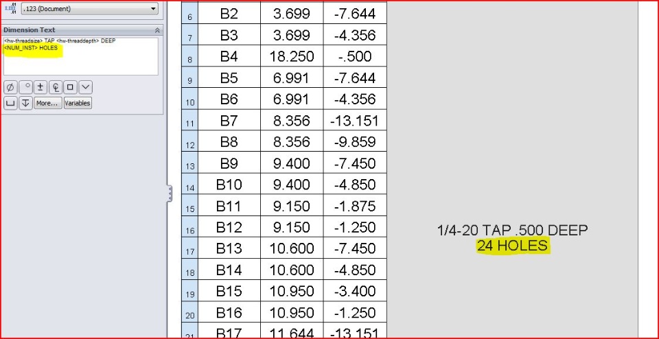

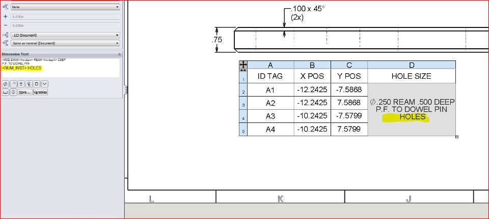

If you use hole tables & just upgraded to 2011 SP4 then any new hole tables you create or old ones that get modified will no longer have the quantity of the holes for each callout. You can edit the hole callout string & add it in but the quanties will not show up. It is reported to have been fixed for SP5. If this affects you the SPR for it is 610875
