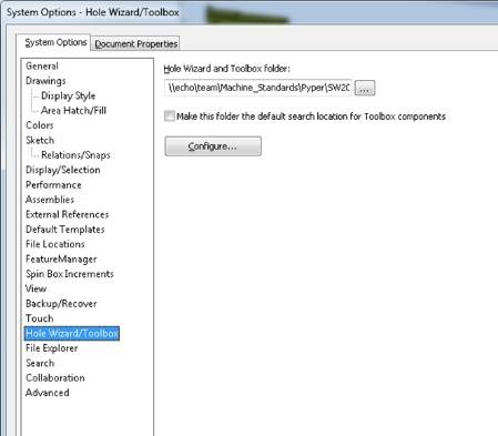

Just a reminder to everyone that uses toolbox parts by copying them to a project/job directory:
When you load the update to SP 5.0 this option will once again get checked automatically.
If you copy your toolbox fasteners into your job directories, you will need to uncheck this box or they will relink back to the toolbox library and ignore the models in your project/job directory.
Tools / Options /  Hole Wizard/Toolbox - Uncheck the option "Make this folder the default search location for Toolbox components
