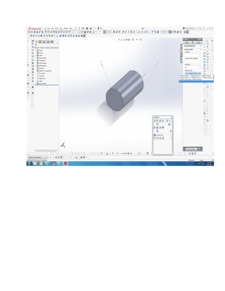

Not sure if this is the proper place for this issue, but I will ask anyhow. I have a template built with the Custom Property Tab Builder that has a finished size tab. It is linked to a text file that has selections for overall sizes in the format, "RD1@annotations" Ø X "RD2@annotations". This allows me to set  ref dims on the part and they will propagate to the BOM. My problem is the "Ø" symbol will not come thru to the BOM. I used the alt 0216 code and it shows up in the text file but once in the propertab tab it becomes a balck diamond with a "?" mark? Does anyone know what I am doing wrong, or if it is even possible to do what I am trying?
