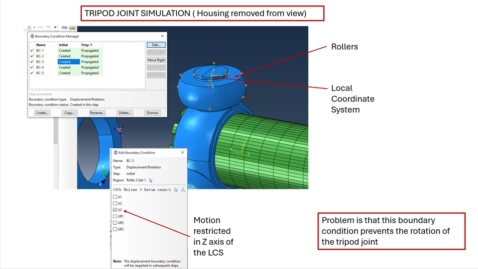

I am working on a simulation of a tripod joint in Abaqus Explicit, where I have applied a rotational velocity to one of the shafts. The challenge I am facing is to restrict the movement of the rollers along their respective axes (Z-axis).
To achieve this, I created local coordinate systems aligned with the axes of all three rollers and applied boundary conditions to restrict their motion along the Z-axis. However, after applying these boundary conditions, the rotational motion of the tripod joint is not happening. On the other hand, if I remove the boundary conditions, the tripod joint rotates as expected, but the rollers slide along their axes, which is not desired.
I have tried my best to illustrate the problem using the attached image to provide clarity. Despite my efforts, I am unable to identify the root cause of this issue.
