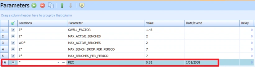

    2. Define Geology - User Parameters - Initial processing recovery REC is 0.86

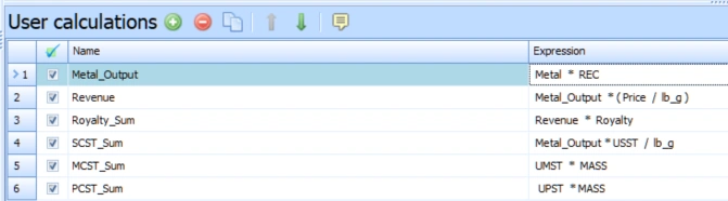

    3. Define Geology - User Calculation - Metal_Output = Metal * REC
    4. Set Schedule - Location - Stockpile with parameters with same initial REC = 0.86
    5. Schedule parameters tab with the changed REC at a specific date on start date of year 2038.

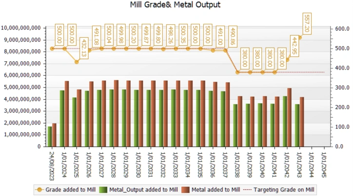

  2. Results

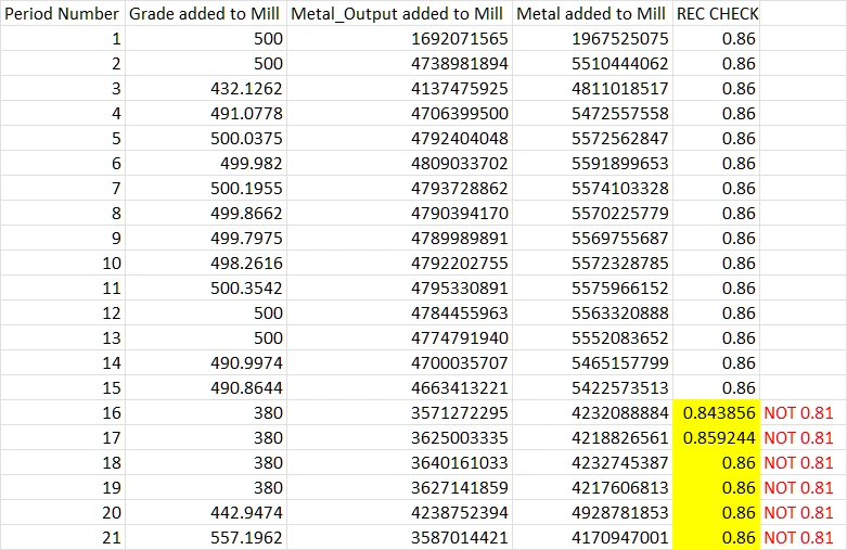

    1. REC check = Metal_output / Metal added to Mill

    1. The results make me confused about how to set up correct variable processing recovery parameters to generate correct metal_output results in MineSched.
    2. My double-check of the results convince me that the REC settings in Stockpile will not change even we give a changed REC in schedule parameters tab with date /event.
