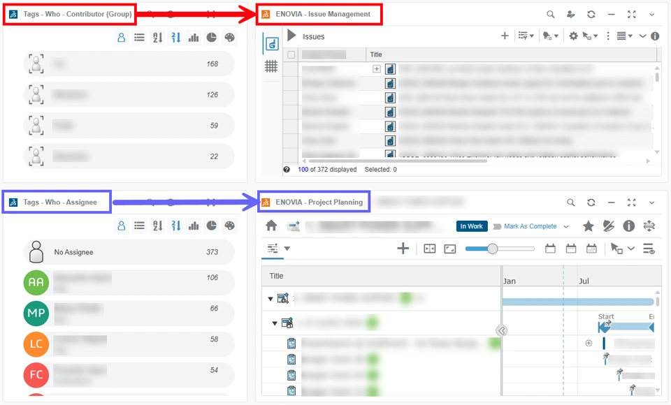

I am struggling a bit with 6WTag filters when multiple widgets are included in the same tab (R2026x FD02 on-cloud).
Can anyone help me to better understand how it works? 🙏
What I found so far
1) When multiple widgets are included in the same tab, all attributes are exposed to 6WTags
2) If nothing is preselected, a 6WTags filter tries to filter every widget; if the relevant attribute is found, the widget is filtered accordingly, otherwise it's blanked
3) If a widget is preselected before applying a filter, it is correctly filtered; unfortunately, every single widget has to be preselected before filtering, which is not very practical
Possible workarounds
1) I am trying to link a 6WTag filter to a particular widget (see image below), but it looks not possible at the moment.
2) Looking for some option to prevent from filtering when an attribute is not found in a widget (option not found yet)
3) Otherwise, the only way to avoid this is using a dedicated tab for every widget
Thanks!
