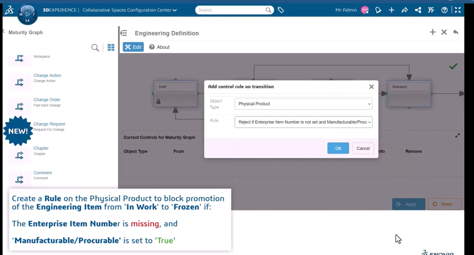

I was also reviewing the latest what's new in FD03 and came across this new rule to make EIN mandatory for promotion.
And this leads to the question how to setup  and use this new attribute.
How is this attribute used? should this attribute become available for assemblies and drawings as well?

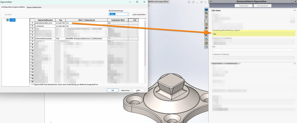

I've build up a property Tab to take advantage of this new setting but am struggling with the definition.
