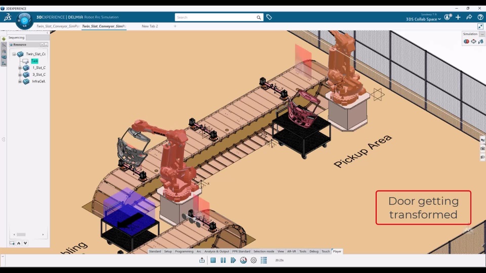

To demonstrate the capability of Slat conveyor simulation and Simulation part creation / transformation, in this workflow a tailgate is shown, which is getting assembled during its course of travel through the slat conveyor. Simulation part creation and Simulation part transformation features of Robot Virtual commissioning provide the tools to Generate the same part many times during simulation and also to destroy the simulated part. Users can control the frequency of generation of parts and also can filter out the parts which are to be transformed or destroyed.

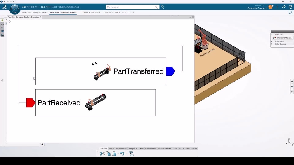

Below video provide a quick overview of the resource signals used on the various devices and IO mapping done between them. Also, the definition of the Robot and device tasks are shown. If you have any queries please feel free to comment below.
