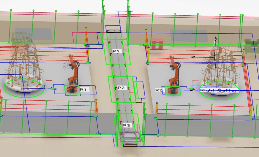

Actually I am trying to make one demonstrator, that includes TIA Portal, CB and 3Dx platforms. I am trying to run the simulation to multiple cycles, but until now no success. Description of demo:
Body In White has a particular location point A on Conveyor, then it moves to point B. There 2 doors are being attached by two robots. Then all the parts move to Point C.
What i want to do is, as soon as BiW starts moving from A to B, I want one BiW to appear on point A. Then same thing i want for doors which are on carrousel. I want them to appear too as soon as robot picks them up. Then when whole car is at point C, i want it to disappear.
How can i achieve this? Which roll do i need specifically?
