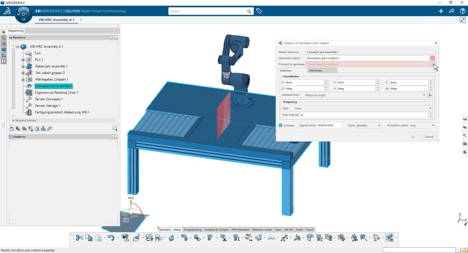

Hi,
When I want to generate a new simulation part on a conveyor in Virtual Commissioning, a new behavior is created in the manufacturing cell. There the I/O NewPart is included. All previously defined I/Os, tasks etc. are only contained in the behavior of the conveyor and I can no longer access the contents of the Conveyor Behavior.
What am I doing wrong? Is it possible that the I/Os and tasks from the conveyor are transferred to the behavior of the production cell?
