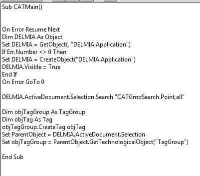

Hello, I am currently trying to use the V5 automation document to help me create a macro that will create a tag/tag group automatically in the DELMIA environment. I am trying to attach tags to points automatically to speed up my robot program creation. I am getting an error on the line 'Set objTagGroup = ParentObject.GetTechnologicalObject("TagGroup")'. Any idea on how to achieve this? Any guidance would be greatly appreciated,as I am new to creating these macros.
