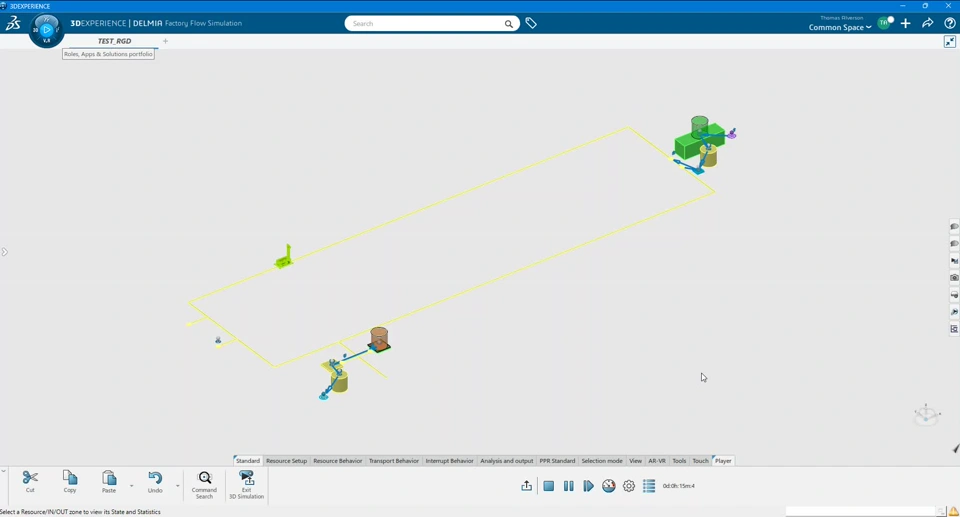

Hello,
2 questions.
  1. Is there a way to stop the mobile resource from leaving the parking decision zone until the products from the machine are finished with the transform? The machine transform is set to 10 mins but the mobile resource starts immediately as the simulation starts. Once the mobile resource loads the mobile storage, it goes to the decision zone next to the machine and waits until the product is ready. I have already tried turning on "Based on Target Request" but this makes the mobile resource not move at all when running the simulation. Is there something that can be done to keep the mobile resource in place until the products are ready to be picked up?
  2. Why does the mobile resource's product zone not move with the mobile resource itself? It shows that the mobile storage and product are being loaded, packed, and unloaded but it stays stationary at the parking zone the entire process.
  3.
    Thanks,
