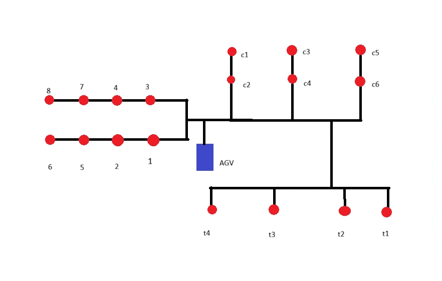

In the figure, 1 through 8 are decision zones where cargo is loaded, c1 through c6 are product zones where buffer activities are set on storage resources, and t1 through t4 are product zones placed on NC machines where transform activities occur.
I want to control the movement of the AGVs.
Like this: 1-c1-2-c2-3-c3-4-c4-5-c5-6-c6
I want them to move like this: c2-t1-c1-t2 after 2 hours, and c4-t4-c3-t3 after another 2 hours.
I tried to implement this using only route group definitions, but I encountered a problem where the AGVs move regardless of priority.
I am wondering if this can be implemented using route group definitions, or if I need to implement it using user logic.
If I need to implement it using user logic, please let me know how.
